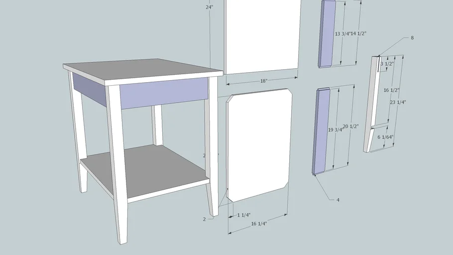

I have built several end tables to this plan, although some are square, 24"x24" and I usually round the edges. The legs are made from 2x4s, the top frame from 1x4 pine and the top and shelf from 3/4" plywood or MDHW. I have used 5/8" particle board before, but with a 1x2" frame to give it a decent edge. #bedroom #end_table #furniture #table
