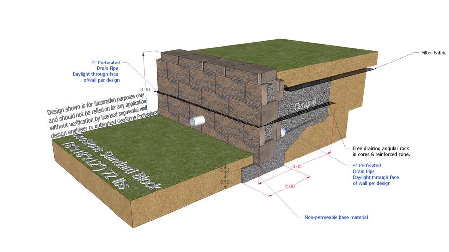

Cross-section of retaining wall using the GeoStone Standard Block (8"x18"x12"). 3 ft high modular retaining wall with all rock backfill, geogrid reinforced. #decorative_walls #GeoStone_Retaining_Wall_System #hardscape #modular_wall_systems #modular_walls #Open_core #Retaining_walls_in_alabama #Retaining_walls_in_Birmingham #Segmental_retaining_Walls
