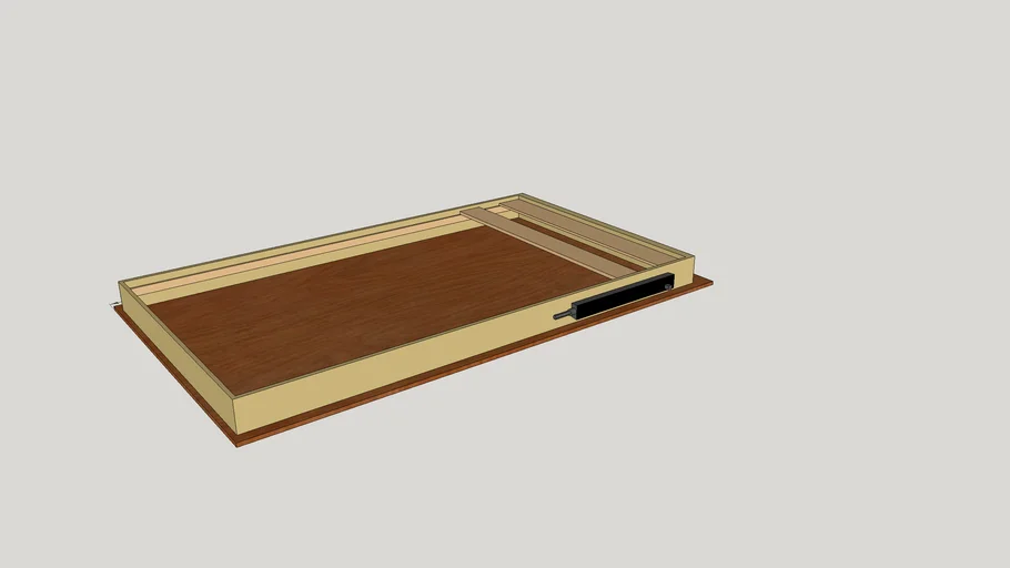

Foldaway wall bed platform using Pardo Patented, Selby mechanism, North American Queen Size shown, fits with NA Queen cabinet or NA Queen space between side cabinets & bridge. Cleats on insides of bed rails shown support foundation slats. Platform is 6-3.4" total depth and positions the BOTTOM of a mattress 12-1/2" off the floor when bed is open or in down position Exposed hardware shown mounted on out side of bed frame For concealed mechanism installation, hardware mounted on inside of bed frame, cleats are fixed flush with top of mechanism housing Foundation or platform consists of 7 equal slats and spaces. Slats are 3/4" Baltic Birch
