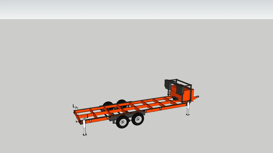

I designed this sawmill to be something I could pull up in the woods and get straight to work with! The idea is that I could saw up all my wood on the spot and then use the trailer bed as a flatbed to bring it all home. I could get more product per trip this way. The trailer is 24 feet long from the tongue to the end. The cutting bed is 20 feet long, but with the tool box and band saw assembly, it can take 18' logs. The cutting deck is 5 feet wide and it can handle logs that are 2.5' wide. The axle assembly is off of a standard car-hauling trailer. The width between the tires is a standard length found on most flatbed trailers. This will allow for a very stable unit that can be pulled over the roughest terrains. #band_saw #logging #portable #sawmill #Trailer
