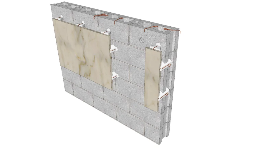

IMI Detail 04.030.2101. This detail shows one option of anchoring dimension stone onto a concrete masonry (CMU) backup using copper wire ties and molding plaster. This detail is intended for the use of industry professionals who are competent to evaluate the significance and limitations of the information provided herein. This detail should not be used as the sole guide for masonry design and construction, and IMI disclaims any and all legal responsibility for the consequences of applying the information. For more information contact sconwell@imiweb.org. #AIA #BAC #bricklayer #Conwell #copper #copper_wire #dimension_stone #dimensional_stone #green #highperforming #IMI #interior #IUBAC #marble #masonry #MDS #molding_plaster #plaster #stone #sustainability #sustainable
