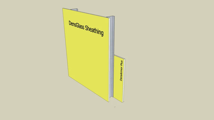

Exterior: 5/8" DensGlass® Fireguard® Sheathing applied vertically or at right angles to min. 3 5/8" corrosion resistant 25-gauge steel studs 24" o.c. with 1 1/4" Type S corrosion resistant bugle head screws 8" o.c. at board edges and intermediate studs. Interior: 5/8" DensArmor Plus® gypsum board applied vertically or at right angles to framing with 1 1/4" Type S bugle head screws 8" o.c. at board edges and 12" at intermediate studs. ***Assemblies are presented for illustration only. It is important that you consult a design professional for assembly information. Georgia-Pacific does not provide architectural or engineering services.*** #DensArmor_Plus #DensGlass #Exterior_Sheathing #Fire_Protection #GeorgiaPacific #GeorgiaPacific_Gypsum #Gypsum_Wallboard #Interior_Wallboard #Moisture_Resistance #Mold_Resistance #Sheathing #Wallboard
