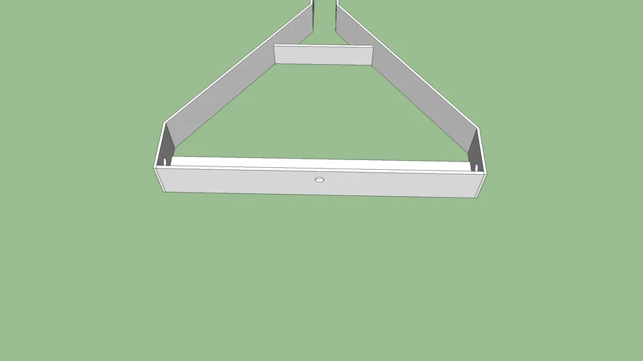

I built this for my compact tractor. It is a standard class 1 three point hitch adapter for a trailer ball. Very handy and simple to build if you have access to a small welder and a chop saw. These sell for $200 pre-built, my DIY cost was $34 and an evening in the man cave. 5/16' flat plate 1/4' 3"x3" angle To shape the angles in the side pieces, I cut 1/8' deep, shaped it in the vice and re-welded the cuts after tacking everything. #three_point_hitch #tractor_hitch #trailer_ball_adapter
