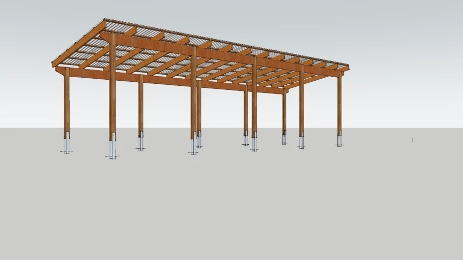

Hi. This is a double in line carport (so two singles on end) that is 12m long by 4.2m wide with posts set at 3.2m apart.
The posts are laminated 130x42 mm LVL's to make 126mm x 130mm posts with the main beam sandwiched between the outer two and sitting on the top one.
Corrugated roof. High wind stirrups.
