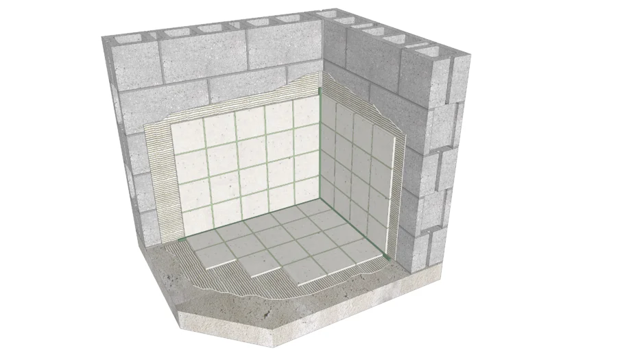

IMI Detail 06.130.1300. This detail shows tile floor and walls laid using a thin-set method. The tile is adhered to the substrate using a dry-set or latex-modified portland cement mortar bond coat. Expansion joints are provided at every change in plane, i.e. wall-to-wall and wall-to-floor. This detail is based on TCNA Method EJ171. This detail is intended for the use of industry professionals who are competent to evaluate the significance and limitations of the information provided herein. This detail should not be used as the sole guide for masonry design and construction, and IMI disclaims any and all legal responsibility for the consequences of applying the information. For more information contact sconwell@imiweb.org. #AIA #BAC #bricklayer #CBU #cement_board #cementitious_backer_unit #ceramic_tile #concrete #control_joint #Conwell #expansion_joint #finish #floor #green #highperforming #IMI #IUBAC #large_format #marble #masonry #MDS #membrane #mortar #movement_joint #porcelain #porcelain_tile #sealant #stone #sustainability #sustainable #thinset #thinbed #tile #tile_layer #tile_setter #tilelayer #tilesetter
