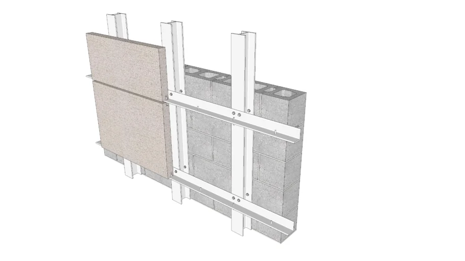

This detail shows one option for anchoring dimension stone to a concrete masonry (CMU) backup using a system of continuous vertical stainless steel struts and horizontal angles with studs welded at top and bottom of the angles for anchorage into kerfs in the stone's top and bottom edge faces. This detail is intended for the use of industry professionals who are competent to evaluate the significance and limitations of the information provided herein. This detail should not be used as the sole guide for masonry design and construction, and IMI disclaims any and all legal responsibility for the consequences of applying the information.
