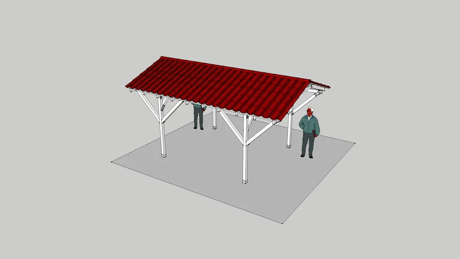

I designed this shed for my 2002 Peugeot 307SW. This project was checked by licenced building engineer and he sayd that it is strong enought, to hold the snow pressure on winter and resist strong wind. When it was ready, I was wondered how strong it is. But unfortunately I made to little fondation. It was 75cm deep and had a diameter of 120mm on each post. When I moved the shed from side to side, the shed self was absolutely monolithic, but it moved with! foundation! If you will build this or similar shed, you have to make deeper, bigger and heavier foundation.
