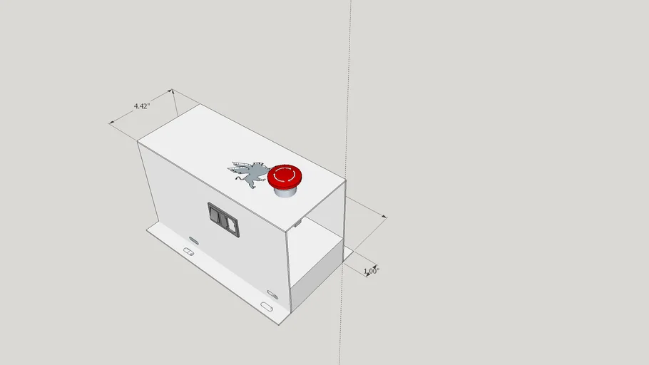

Click the rotation icon for a 3d view. Switch, circuit breaker and outlet openings on the right side of the box would only be scored for the user to punch out if needed - we can use the same specs on the concrete printer panel for these. The box inside the model is a mockup of the power supply at actual dimensions. I will supply all parts for reference. Length (approx) - 10.4" Top width - 4.4" Sides Height - 6" Feet flanges - 1" Thickness - .08 - same as Concrete Printer panel plate.
