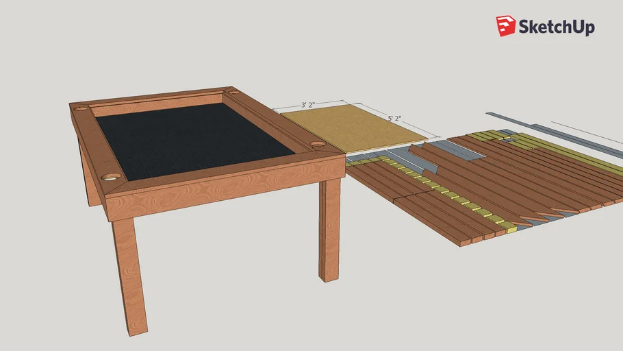

#GamingTable that I designed based off of the table found on boardgamegeeks.com (https://www.boardgamegeek.com/thread/1471747/build-gaming-table-150). My design turns the table into a rectangle vs a square and I didn't include the location for a TV. My original design had a wider leaning ledge and shorter apron but I reversed my measurements when cutting the boards and had to redo the model to make sure the rest of the cuts supported building the table. The model includes the lengths of boards and cuts that I used for building the table.
