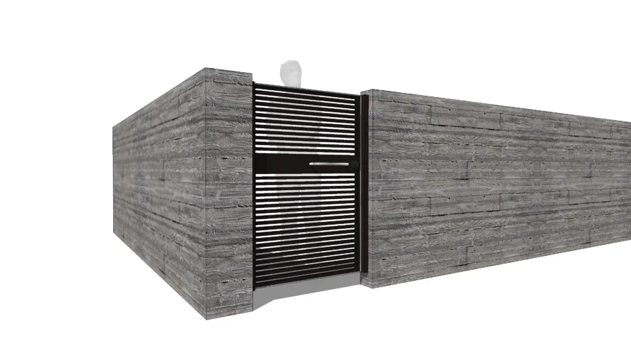

Custom gate door with:
-- 2x1x1/8" 6063 aluminum for frame, welded and ground smooth (keep raw or clear anodized)
-- 1x2 wood slats, stained and sealed
-- 2x6 panel to support bolt attachment, stained and sealed
-- Kwikset Uptown deadbolt
-- stainless steel pulls
-- Sugatsune JSA-180A aluminum *spring* hinges, either welded or screwed to frame.
