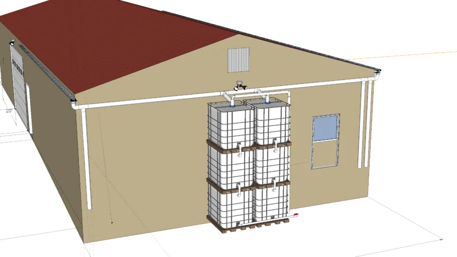

Rainwater harvesting design is expandable as time allows. The water diverters both left and right hold the necessary 15 gallons of diverted dirty water. I will likely use a commercial ball and tee joint option for the diverter fittings. Used food grade totes are used as they are cheap and available. The system is a closed system of vents. Holes will be drilled at the top of the bottom four containers and connected to the built in fitting above. The vent out the top will allow for air flow for emptying and for overflow. #Catchment #Container #Diverter #Flow #Harvesting #PVC #Rain #Rainwater #Shop #System #Water
