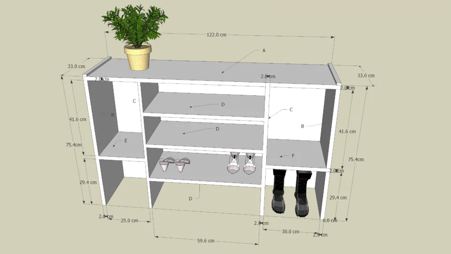

This is my unique design shoe-self. Don't expect you can buy it from anywhere. Tips for building your own My Shoe Rack: 1. On the back of the rack, you can use either a thin board to partially cover the top two corners, or use two long 1x2 cross four corners to strengthen the whole rack structure. 2. The thickness of the boards does not really matter. You can ask HomeDepot to pre-cut them. Only one board needs to be re-cut when you get home. Guess which one? 3. When you cutting the board, put the fine side down. #shoe_rack
