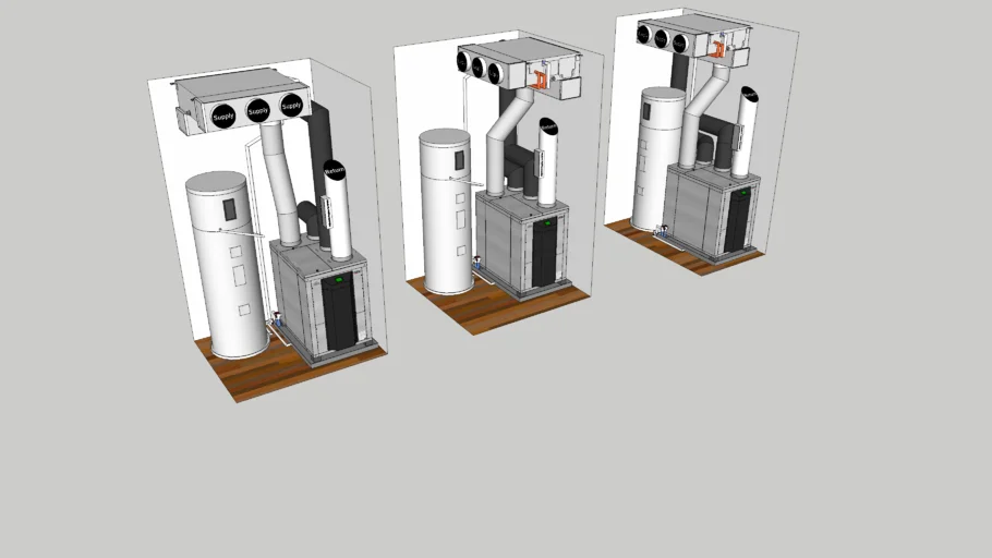

*This set of examples shows integration between the CERV2 and Mitsubishi/Trane PEAD-A12AA7 1-ton ducted high efficiency heat pump. The indoor unit may ONLY be oriented horizontally. CERV2 Magic Box Mechanicals provides all ventilation, heating, and cooling through one duct network, perfect for small, low load homes and multi-family applications. Including a heat pump water heater (HPWH) in the mechanical room and this small footprint supplies unmatched air quality, comfort, and water heating performance. Design Tips: • The output of the CERV2 may be connected to the inlet of the mini-split using insulated flex duct. • 8x10 rectangular metal ductwork works great for the mini-split plenums! • Be sure to check the CERV2 and heat pump installation units for installation requirements. These models are intended to be conceptual examples While designed to be as dimensionally accurate as possible, they should not be assumed to be exact.
