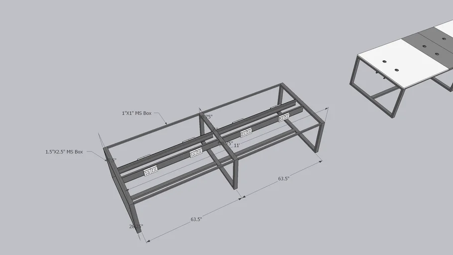

Developers Room Table (11'-0"X4'-0") Made By: 1. Main Frame: 1.5"X2.5" MS Box 2. Bottom Horizontal Bar 1.5"X2.5" MS Box 3. Frame Top Horizontal Bar Should Be 1"X1" MS Box. 4. Cable Tray Should Made by 1.2mm MS Sheet and Hings System 5. All Complete with powder coated paint.
