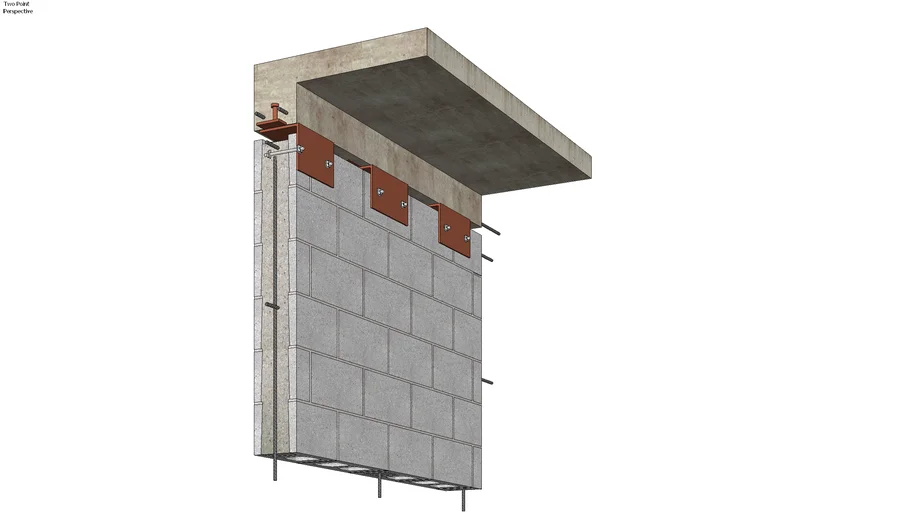

This detail shows the termination of a reinforced concrete masonry wall at the beam above. 12" long angles at 24" o.c. are welded to embedded plates in the overhead concrete, restraining lateral movement of the wall. The top of the masonry is held 1 1/2 " below the bottom face of the concrete. The top course or second course from the top is fully grouted to form a continuous bond beam. This detail as shown is intended to illustrate a general concept or method of construction. Details that show different or modified concepts or methods can be of equal validity and should not be excluded from consideration. this detail shall not be used for construction without the approval an signature of a licensed design professional. The person using this detail shall be responsible for its complete design and proper application.
