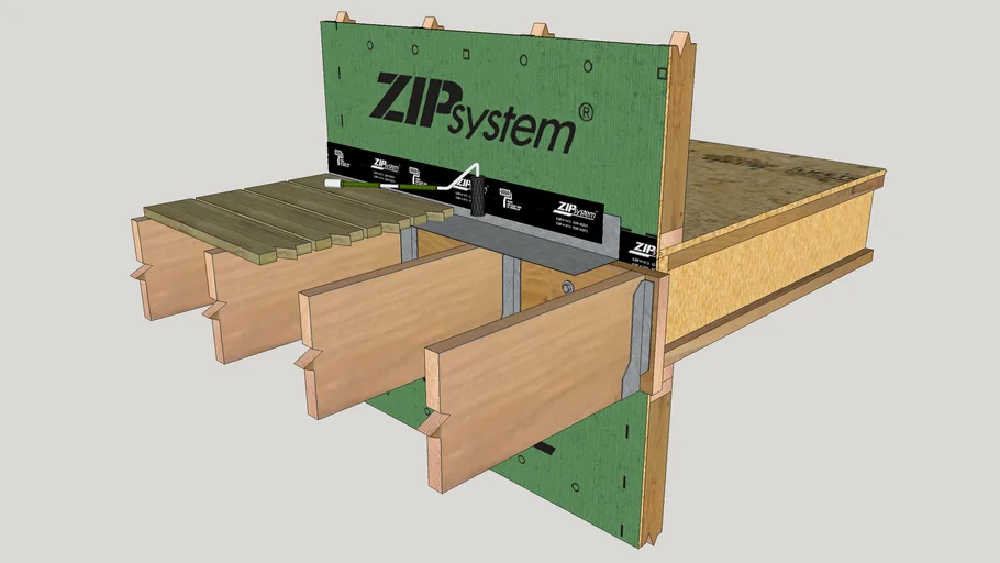

Deck Ledger with ZIP System
Huber Engineered Woods, LLC.
ZIP System® sheathing are wood structural panels with built-in, protective overlays that eliminate the need for building wrap or roofing felt. It is code recognized in ICC-ES ESR 1474 as an alternate to the water-resistive barrier required in Chapter 14 of the IBC and Chapter 7 of the IRC and satisfies the requirements for air barriers as defined in the ICC International Energy Conservation Code. It is also code recognized in ICC-ES ESR-1473 as an alternate to roofing underlayment (felt paper) required by code when panel seams are taped with the ZIP System tape. #construction #deck #house_wrap #ledger #osb #sheathing #system #zip
