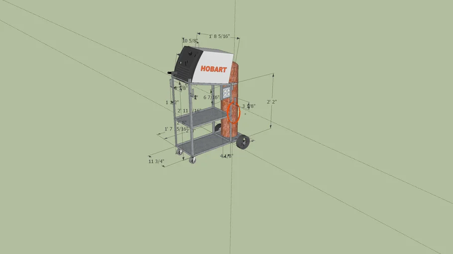

First welding project with new welder. Built almost exactly like design and came out very good. Used 3/4" x 3/4" x 1/8" angle. It's plently stout for the welder and 80 cubic foot Argon/CO2 tank. Used 18 guage metal for bottom 2 decks and 1/2" plywood for top deck. #project #welding_cart
