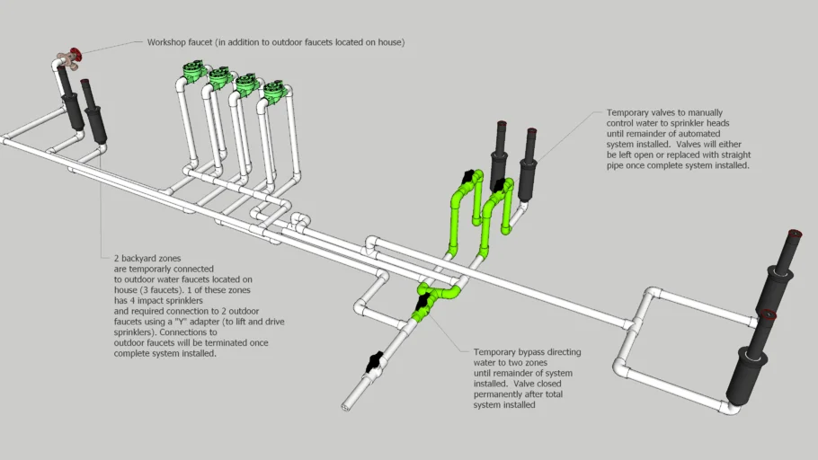

This system is a work in progress. Sprinkler heads and plumbing were installed prior to installation of the sod in both the front and backyard and required temporary connection to water sources prior to installation of the entire system. Once the valves and controller are installed the temporary connections to the main water line and outdoor faucets will be terminated. I live in southern Texas so will use above ground jar top anti siphoning valves. Valves will be at least six inches above the highest elevation sprinkler head. Valves will be located on the side of the house and a box cover will be installed to protect against a rare winter freeze potential. #irrigation_system #sprinkler #sprinkler_valves
