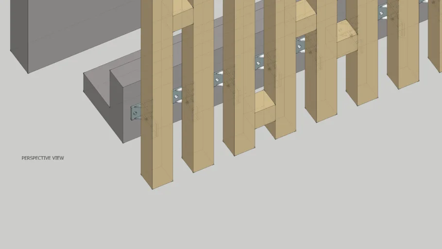

The model shows GRC ( Glas the fiber reinforced concrete ) fins to cover the toilet shaft in a building. The details shows the bracketting and the inserts in the GRC fin of size 130x130x3.3 m . The GRC fins are further connected to each other with a false connection of the GRC only of size 130x130x130 mm at varying heights. #Bracketting_detail #concrete_fin #concrete_louver #facade #fin #GRC #GRC_louver #toilet_shaft_facade
