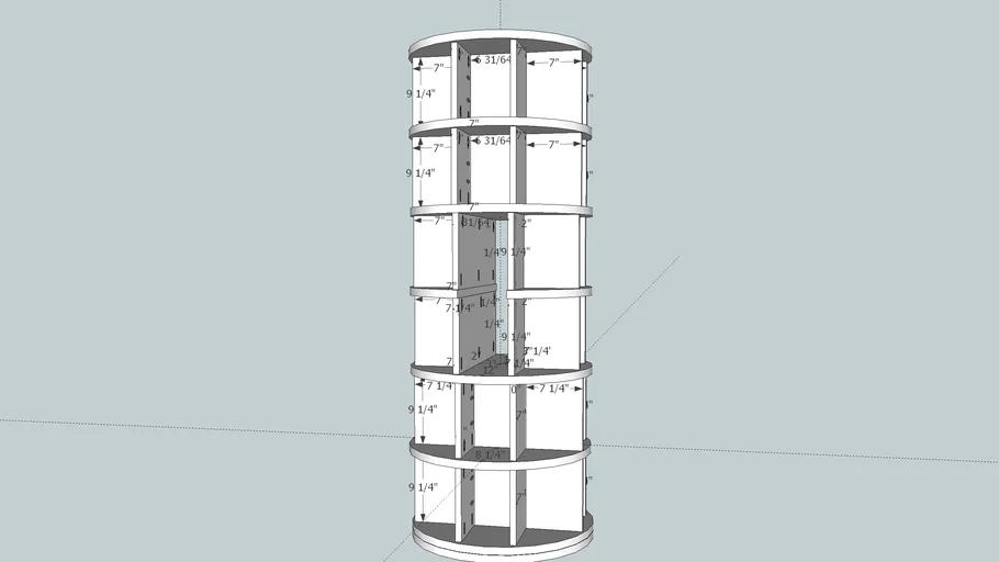

Revolving bookcase made from standard 1x10 boards and pre-cut 24" table rounds that can be bought at home improvement stores. Note that some of the rounds are cut to allow for the taller cubbies. A heavy duty lazy susan would be between the bottom two rounds, screwed into both rounds. Ovals are pocket screw holes. It is recommended that heavy items be put on the lower shelves to reduce potential for tipping.
