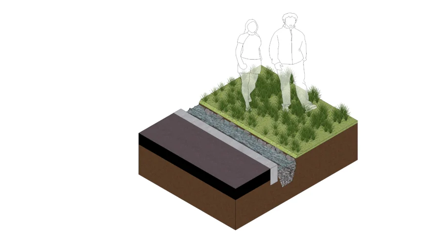

Benefits: System that allows intercepting runoff to be conveyed to a retention, infiltration or flooding zone. This aggregate version is an economical technique for water drainage that can be easily integrated into the urban landscape. Design and implementation: The design should carefully consider the local topography to ensure the flow of runoff for both initial interception and conveyance to a complementary filtration system. It is recommended to use clean aggregates (without dust) with a diameter greater than 5 cm. Objects developed within the framework of the project INTERLACE by YES Innovation https://www.yes-innovation.com/ nature-based solutions #NbS Soluciones basadas en la Naturaleza #SbN
