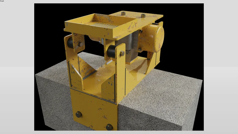

Made this for my friend. He is using bent machines for bending aluminium and PVC profiles . One of steps for preparation before bending is to fill all cavities of the profile with fine sand to control bending quality. Filling with sand or removing the sand after operation ,require shaking/vibrating the profile for both operations. Motor modeled by me from catalog image is from BRECON Germany Image is rendered in Thea Render
