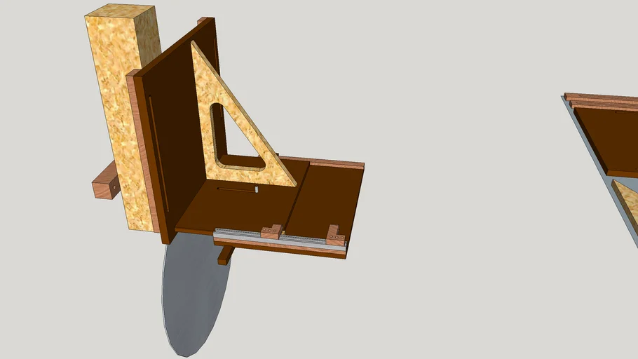

Woodworking jig for cutting tenons on multiple work pieces at one cut on a table saw. Try to move the Group which in on "Sliding jig part" layer along Red axis to jet how it slides and registered on stop block. The left stop block position register the left-hand cut of the tenon shoulder. The distance between two blocks equal to tenon size. No need to reverse work piece for the second shoulder cut.
