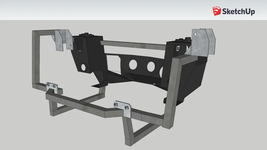

One of the things that was difficult to do with the subframe was to get a set of plans. The closest I got was a set of photos from Dutchy's build (www.dutchysmini.com) that included some dimensions in inches. Now that I've essentially got a frame that is fitted into the Mini, and the Engine also fits in the frame, I took a bunch of measurements from my frame, and spent the last few days creating a 3D model of the subframe in SketchUp.
