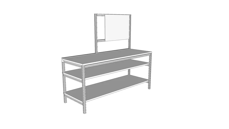

3x IKEA Ekbacken countertops 1x IKEA Skadis hole plate for tools The rest is 40mm aluminium profile (I-Type), but any sturdy frame would work. I've used the shorter countertops (186 cm), but you can stretch the frame to work with 246 cm too. The lower two countertops need two 40x40 mm cutouts each at the rear corners to accomodate the rear legs. Total cost excluding fixtures like screws, nuts etc. ca. 700 € in may 2023.
