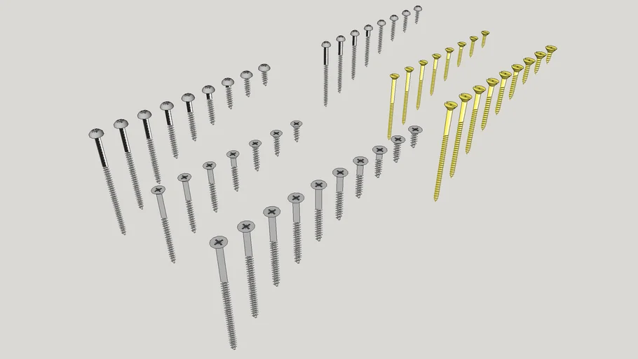

Woodscrew components in lengths from 1/2 inch to 3 inch. Screw profile has shank and image of twin-thread woodscrew on a rectangle that 'always faces camera'. Revised so that countersunk screws 'cut opening' in the face they are inserted onto.
Import model, then use Window/Component browser, => menu, Expand to see individual screw sizes.
Drag needed size from component browser onto any face of your model, and it will glue the screwhead to that face, and if it is a countersunk woodscrew, will cut opening for the screwhead.
Use menu View-> FaceStyle-> X-ray to see screw shank detail in model.
Head socket, shank and screw thread are on separate layers (Screw head detail, and screw shank) which you can turn off to minimise model size when internal details are not needed.
Consolidated into one file from six previously separate files, and added Cut opening to countersunk screws.
