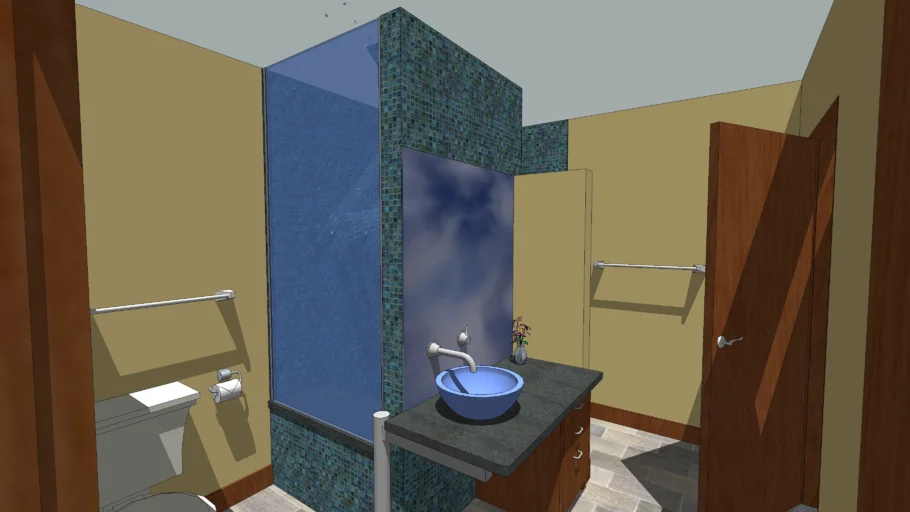

This is an efficient bathroom design you might find in an upper end condo. Contemporary casework and sink, and a drilled mirror for the vessel sink controls. The shower has 1" square glass tiles, a glass wall and a generous integrated bench seat. The shower has 3 square Kohler Watertiles that each provide 22 individual bodyspray jets. I took the artistic license to include enhanced water spray to demonstrate functionality. Note to designers- I don't like these vessel sinks without overflow drains, make sure to provide an integral floor drain. If a manufacture is going to charge big bucks for this sink design, an overflow should be thoughtfully included in the design. Be certain to select a faucet stem that is tall enough to provide ample space to wash you hands without being impeded between the faucet outlet and vessel's drain (an annoyance to me because I have big hands). Also watch ADA with these nightmare sinks in commercial applications. The Kohler Water tiles aren't exactly efficient in multiples either. The shower layout could be better designed and spray less if the controls and spray heads were mounted counter position to the seat IMO, although the present design does keep all plumbing in same wall cavity. Buyer beware. : ) #Bathroom #contemporary_bathroom #Efficent_bathroom #glass_tile #Kohler #restroom #shower #toilet #vessel #vessel_sink #watertiles
