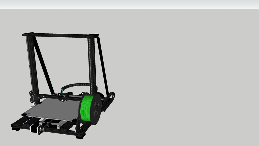

This is my first version of my upgraded Cr-10 S4 The peculiar upgrade, that made me start this project is the absence of external control-box. I wanted a more efficient space and there was a lot of empty space under the bed. So i made a polystyrene case joined with extruded aluminum. Instead of OEM controller-monitor, i'm using Octoprint for controlling remotely. Steel reinforced Z-axis, for improved marginal stiffness when moving the Y-axis. All cables have been re-made, short or longer for better cable management, also fixed in a fixed position, with the help of a cable chain. Only the bed cable is still freely floating, but thankfully it does not create any problems. See also my OEM Cr-10 S4: https://3dwarehouse.sketchup.com/model/4bd58fc9-e47d-4e00-84ff-aaee1719b05f/3D-Printer-Creality-CR-10-S4
