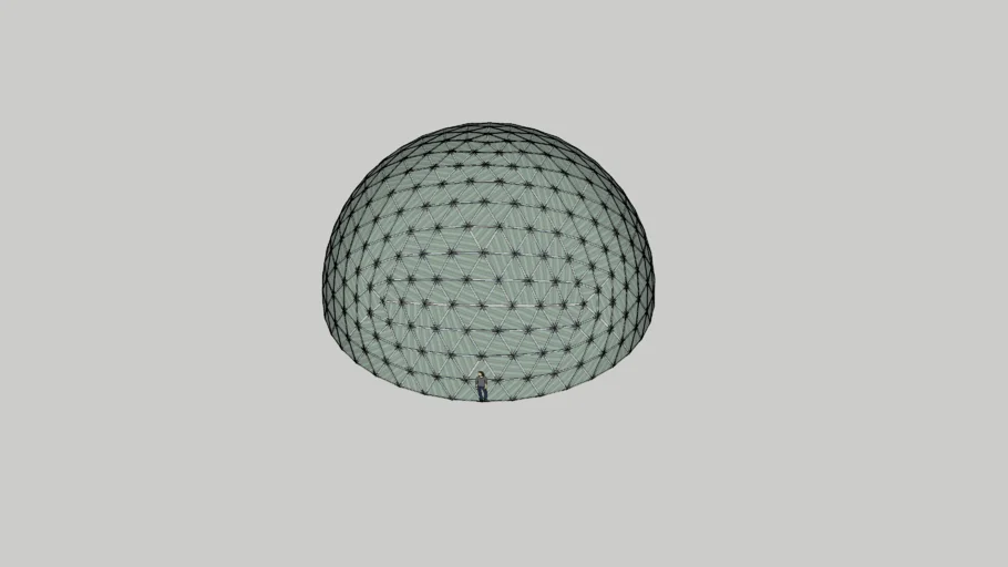

An 8V Icosahedron Dome built on the same method as innodivergence's youtube channel. It winds up being a hubless construction. The size is d=52' h=26' using US standard lumber sizes. In practicality, there are almost a thousand cuts on a compound saw, but less than twenty unique angles on it. This was the largest dome I could get using standard 8' lumber, 2 struts per 2x4 on an 8v. High use of components, faces alternate for clarity. With glazing added in thickness of triple walled polycarbonate. Icosahedral faces grouped to aid construction. If you build this you have to share pictures! #8v #alternate_greenhouse #dome #edge_dome #face_dome #geodesic #hubless #icosahedral #icosahedron #innodivergence
