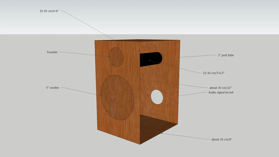

This speaker box is somewhat the same design that i use at my home. as you can see, i have written for example "about 20 cm". this is because i am giving you the option of the size of the box however you like. A little info about the port: If you want to have a deep sound effect, it is recommended that you use a somewhat longer port tube. if you want as loud as possible, you want it a little shorter (my design says a minimum of 12 cm (5"), but you can go lower to 8 cm (3"). you can of course make your own port by using an "empty" paper roll of some sort. #ported_speaker #Speaker_box
