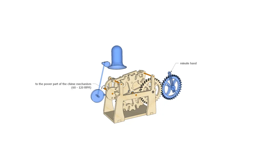

Only for non-commercial use. This mechanism eliminates the disadvantages of counterpart counterparts and retains the advantages of snail mechanisms. It is also easy to manufacture and has small dimensions. The power part of the drive of the shock mechanism (kettlebell or spring) is not shown, because similar to traditional designs. All elements are made of 4 mm birch plywood. Axes are metal. I will be happy to help if you have questions when repeating this mechanism. It really works! #chime_mechanism, #clock #real_clock #wooden #wooden_clock #gears #wooden_gears #its_working
