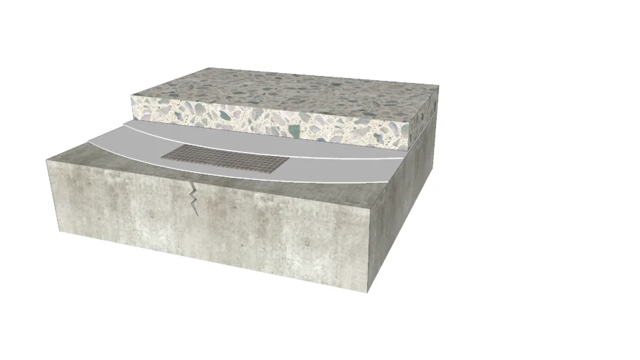

07.130.0326 Floor Detail - Polyacrylate Terrazzo | Partial Crack Isolation Membrane
International Masonry Institute
This detail shows a polyacrylate terrazzo floor installed over concrete with cracks. A partial crack isolation membrane of specified width is selectively placed over existing cracks to prevent the cracks from telegraphing through to the finish. The person using this detail shall be responsible for its complete design and proper application.
