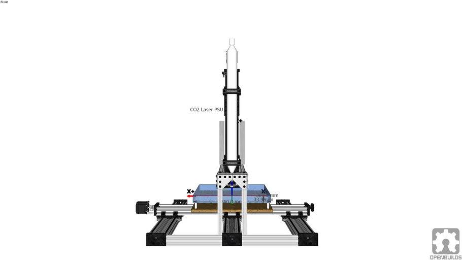

This build is a derivative of the popular MiniMill CNC (http://www.openbuilds.com/builds/openbuilds-minimill.5087/), adapted for use by a C02 laser tube instead of a router, and its size expanded to provide for triple the cutting area (360mm x 360mm) It's important to note that this is a work in progress and is not yet, in my opinion at least, ready for construction. It's missing many finishing touches like connectors, etc, and may require additional engineering to shore up strength in certain weight-bearing areas. Special thanks to Don Kleinschnitz for his continued collaboration over on OpenBuild's G+ Community (link below). If you'd like to contribute, please feel free to join in the ongoing design thread or post your own build concepts. #cnc #cutter #k40 #laser #laser_cutter #mill #mini_mill #minimill #openbuild #openbuilds
