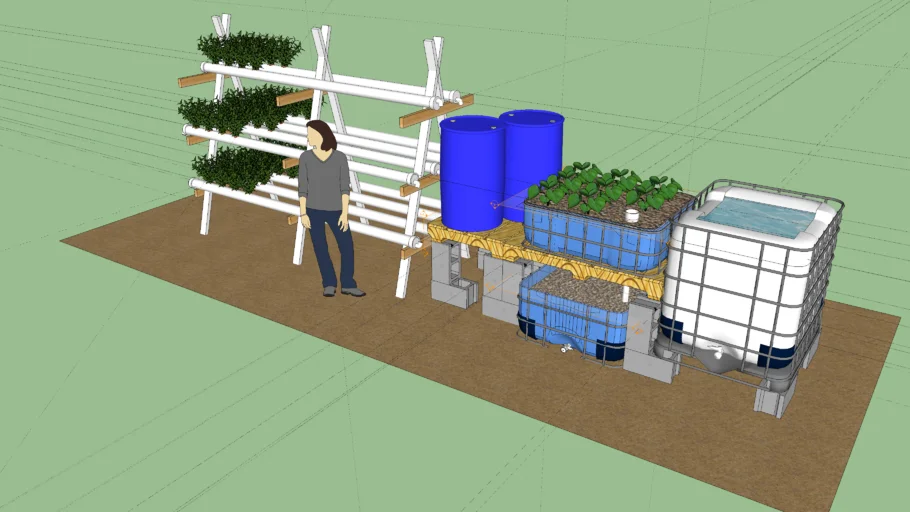

Maximizing production while minimizing cost of materials and space used. IBC fish tank overflows to IBC flood & drain media beds with worms to digest solids. Pump in media-filled IBC sump pushes water into aerated swirl filter barrels for a more complete breakdown of solids which then passes into the series of NFT pipes with another outlet going back into the fish tank. Pipes drain back into the sump. This is a modified CHOP2 design that can be installed above ground and easily modified or extended to suit nearly any situation. #aquaponics #fish #flood_and_drain #food #gravel #IBC #media_beds #NFT #plants #plastic_barrel #recirculating_system #system #vertical_grow
