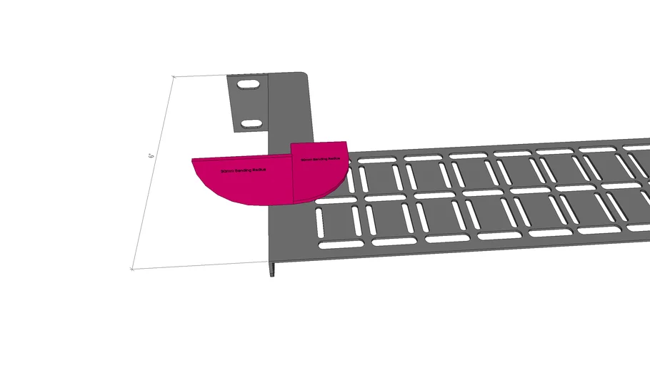

Keeping in mind that if you exceed the minimum bending radius of your fiber you cause all kinds of bizzare problems.
This is based on the Kendall Howard RS-K13-971-1U units.
We use velcro thru the manager slots to secure the cable down and it aids us in keeping from "overbending" the fiber
