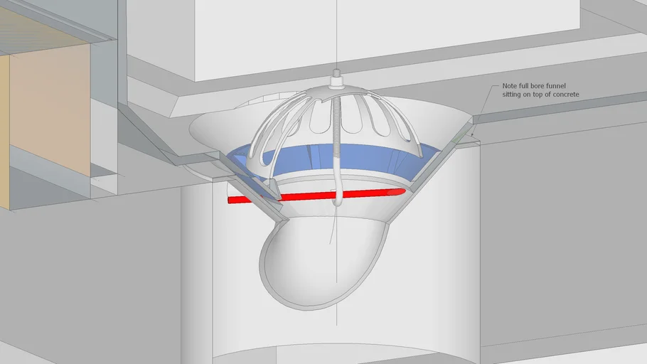

New Full Bore outlet on existing concrete flat roof. Also shown are stormwater feeder pipes on new torch-on waterproofing keeping excessive water off the roof surface. Also off-centre handrail protection at edge of roof, AC condensers and other giblets demonstrating to the client the overall repair design. Vollauslass salida de paso total
