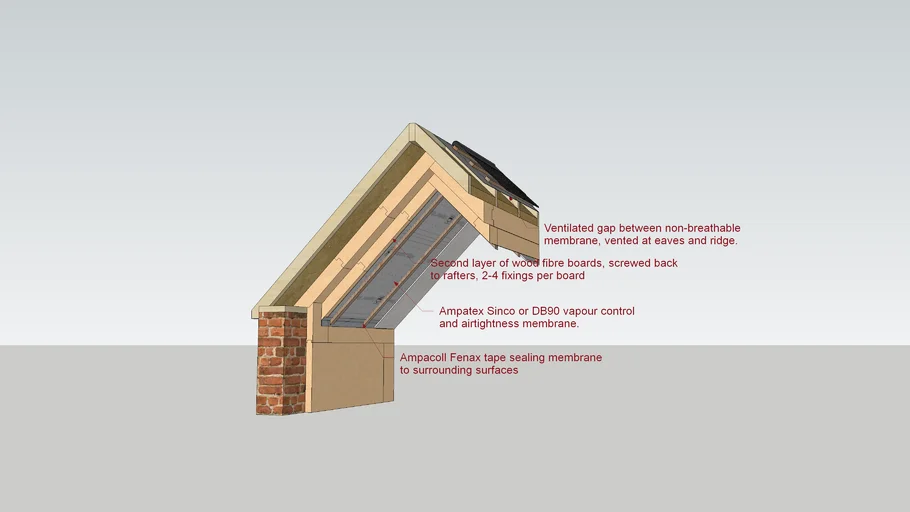

Wood fibre insulation on pitched roof - internal boarding - step 3
Chris Brookman
This model shows the final step in insulating your roof structure with wood fibre insulation from the interior.
