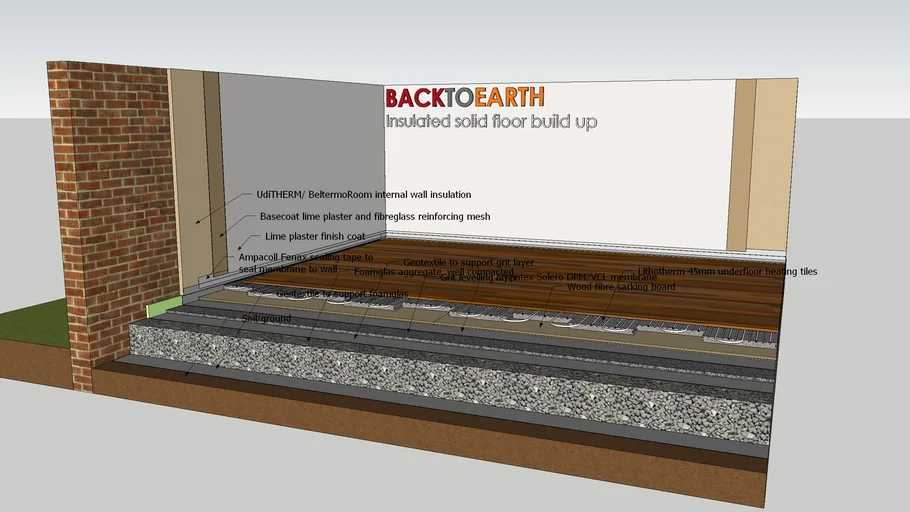

This model shows how are Lithotherm underfloor heating system sits within a concrete-free breathable floor construction. This is ideal for use on older buildings, where Radon may be present (the VCL would be switched to a radon barrier) or where there may be high levels of moisture in the ground.
As you move to the walls, the model shows the simplicity of the transition to the wood fibre internal wall insulation. Please note the ground level and floor level differences as the model would change if they were at the same level.
