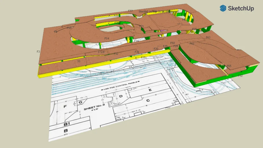

HO scale model train layout benchwork plan from Atlas King Size Book from 1972. The dimension I used for the pine lumber is 0.75 x 2.5 inch for the 1 X 3 (yellow) and 0.75 x 3.5 inch for the 1 X 4 (green). This is the original plan with error corrected and some modification made. Shims were added to compensate the slightly larger lumber used in the original plan.
