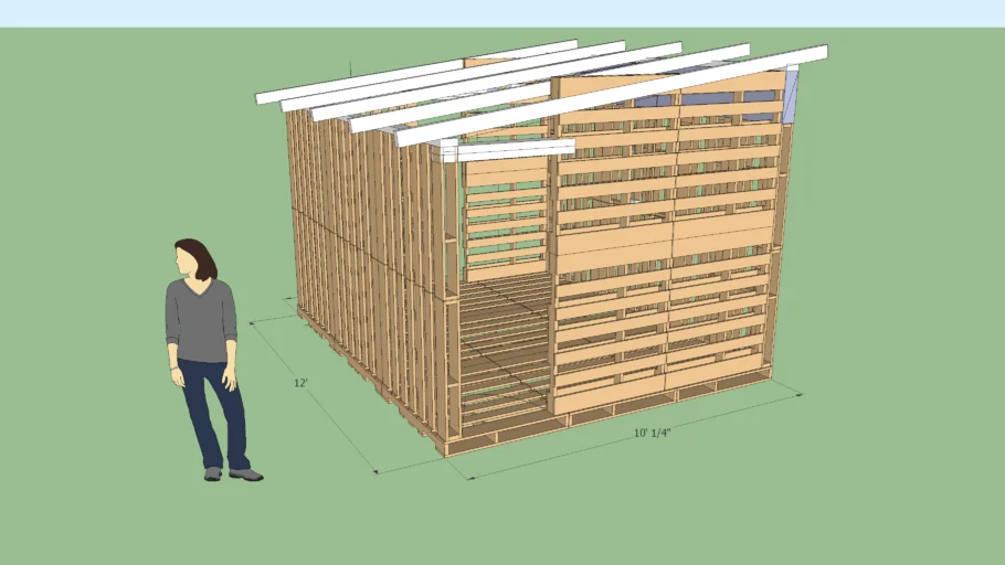

10'x12' pallet shed that I designed to create extra workshop and storage space for my small bussiness. I used 30 to 35 pallets that were all roughly 40"x48"x5". It did the job and is plenty sturdy. I used exterior 3"+ screws throughout. Saved $500-800. #10x12 #120sqft_shed #cheap_shed #lean_to #pallet #shed #workshop
