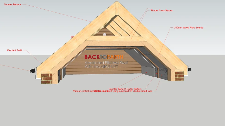

Here we can see the partial fill of the void between the rafters with ventilation points through the gables and soffit, and wood fibre insulation installed underneath the loft floor.
