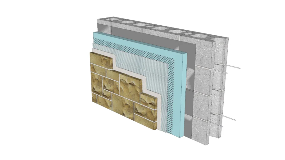

This wall system shows adhered stone veneer over concrete masonry backup with continuous insulation. The thin stone veneer is bonded to the metal lath with a base coat and bond coat of mortar. The lath is anchored to the backup with mechanical fasteners through the insulation and into the block backup.
