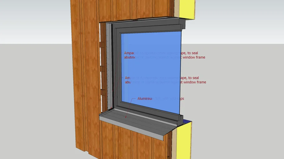

Wood fibre insulation - Window detail in clad facade - Step Four
Chris Brookman
With the counter-battens in place you can either fix horizontal cladding or horizontal battens to fix vertical cladding to. Once the sill is installed, apply a strip of Ampacoll Komprimax joint sealing tape to the top of the sill end cap and the edge of the window frame to ensure the cladding boards seal against it. Ensure there is adequate drainage behind the cladding to prevent water penetration.
