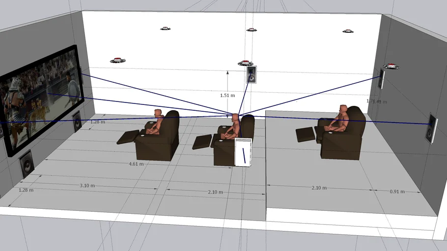

Dolby Atmos 7.2.6 Speaker Placement Layout virtual map based on Trinnov Whitepaper 2017 Recommendations for Speaker Layouts and Dolby ATMOS Home Theater Speaker installation 2018 guidelines. * optimal room size accordign to The Golden Ratio, 1968 - H1 x W=1,62H x L=2,62H (room dimentions within the acoustical room-in-room) * 3 rows of seats at optimal viewing distance - for 4K UltraHD = 1-st row with SMTP 61 degree / 0.84W for 2.35 screen - for 1080p = MLP = 2-nd row with SMTP 43.3 degree / 1.26W for 2.35 screen * MLP = 2-nd row = made as combined object of MLP seat + 7 speakers of Bed / Ear-level layer + 6 speakers of Atmos Upper layer optimized for 3 rows (you can put it in your project and with the help of directing rays you find the positions for the surround speakers - basic tool) * 2 rows layout = delete the 1-st row * 3 rows layout = make the podium of 0.3 m in hight for the 2-nd row + add 0.3 m to the height of the 3-rd row + all 7 speakers of Bed / Ear-level layer mount 0.
