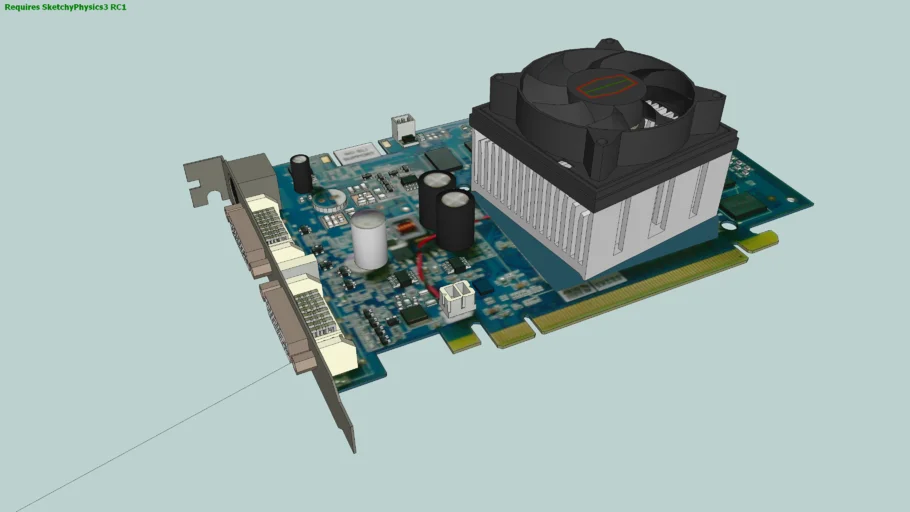

Another of my PC parts. The stock fan of the 9400GT burnt, just stopped turning whenever it felt like it, and i couldn't find the warranty proof any more, so I went in the garage and opened up some old computers and i found another heatsink and fan that would fit on my card, previously mounted on an AMD Duron (1998-2001). New frequencies: core clock:770 Mhz (550 stock, 40% overclock) memory clock 570Mhz (400 stock, 42.5% overclock). T° at idle is 34°C and I got to a max of 46°C. #512_Mb #512Mb #9400 #9400_Gt #geforce #geforce_9 #geforce_9400 #geforce_9400_GT #geforce_9400GT #my_PC #my_PC_case #my_PC_parts #nvidia #pny #sketchyphysics #sp
