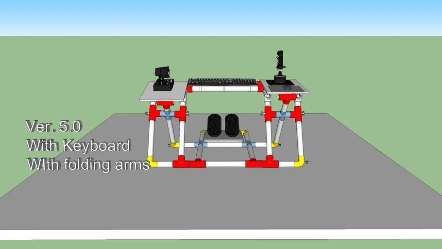

W-36" x D-28" x H-24" Build to suit you. (Without Joystick) 2 - 10'x 1" PVC 13 - T Connectors 4 - Cross Connectors 8 - 90 Elbows 4 - 30 angle elbows 1 - 6'x 1/4" rod woth thread (Match wingnuts) 8 - Wingnuts 8 - Lock washers x - Screws to hold flat board/plastic in place (Velcro may work) Cotter Pins - Lots Velcro Cable Management Velcro Holds Fighterstick,Throttle & keyboard in place (Place soft Velcro side on bottom of keyboard) Ducttape 'lattice' holds footpedals Try on for size before putting cotter pins in place Rod allow you to collapse stand for stowing. See "CH Products F-16 Fighterstick, Throttle, Foot Pedal Keyboard Stand Ver.5 (FOLDED)"
